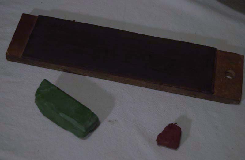

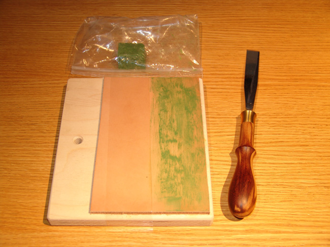

Well my mail person brought me an unexpected box today and I am thrilled at the contents.
The other day JJ and I were talking about sharpening.  I mentioned that typically I sharpen, with wet stones, my chisels and planes after every two guitars that I build.  I also mentioned that I am now able to sharpen to the point where the blades will pop hairs off from the backs of my hands.
JJ asked me if I "stropped."  I didn't know what stropping is/was and he explained it to me that it will prolong the edge on tools.  And then we moved on to another topic.
Today in the mail I received this "hand made"....... stropping station complete with additional compound and some very clear instructions from JJ.  So clear in fact as to even indicate where I might "store" this device when not in use.......  This is why the note is not being posted.......
This thing is beautifully made and more importantly it works like a charm.  I took my favorite chisel and prior to stropping it would no longer pop hairs off my hand.  I followed JJ's instructions, except the part on where I could stick this thing when not in use......., and now this chisel is again popping hairs off my hand.
Many thanks JJ - you are a wonderful guy and a true freind.
Check it out:

PostPosted: Sat Dec 15, 2007 10:41 am
Posts: 140
Whats it made from (leather?) what do you use as a polish.
more importantly can we make make one of these at home.
I could do with a new strop
Joel
PostPosted: Sat Dec 15, 2007 11:12 am
Posts: 2711
Location: Victoria, BC
Last Name: Abercrombie
[QUOTE=joelThompson] Whats it made from (leather?) what do you use as a polish.
Joel[/QUOTE]
Joel-
No doubt Hesh will be along with the details shortly.
I'm still using my homemade strop from years ago- about 2.5 x 8.5 inches, plywood with leather glued to it. For leather, sometimes you can find a wide leather belt or a good quality handbag at the thrift shop. Of course if you have a leathercraft store nearby they will fix you up. For compound, I use jewellers rouge and lately have been trying out the LeeValley green honing compound. Both work.
BTW, LeeValley sells a 1" leather belt that goes on a 1x30 or 1x42 belt sander which you can use for honing. I find that it is 'somewhat' useful for putting an edge on utility knives and the like, but it tends to round over the edge on chisels, so I do the 'good stuff' by hand.

PostPosted: Sun Dec 16, 2007 2:45 am
Joel, I can help you out a bit. It's tooling leather. If you need a piece I can send you some. JJ will have to answer the polishing paste question though.
PostPosted: Sun Dec 16, 2007 3:14 am
The green compound is from Lee Valley and it's simply called "Honing Compound".
I'm sure it has a measured abrasive particle size but I don't have that information.
Lillian's right on the leather. I simply glue it (Titebond, I think) to a dead flat piece of 3/4" Baltic Birch Plywood. I put compuond on one side and leave the other untreated. I swipe the bevel and back against the treated side a few times and once or twice on the untreated side.
BTW...NEVER push the blade along the leather...always pull it toward you.
PostPosted: Sun Dec 16, 2007 4:00 am
Posts: 242
"what the green compound is as well."
Hesh,
It's Green Chrome Rouge. It's used a lot by custom knifemakers. You can also get it at most knifemaker supply places. Google is your friend.

I must say that I'm really quite surprised this is the first time you guys are discovering the strop!
It is one of the most important tools on my bench.  I discovered it via a wood carver freind of mine while trimming my first top to size. He took what I thought was a dang sharp chisel, touched it up with 400, 600, 800, 1000 and 1200 and 2000 grit sand paper in the same manner we level a finish.   Then he took some 600 grit aluminum oxide powder, charged his leather strop with it (by pouring some on the leather) and proceded to put a mirror finish on the blade.
When I tried the blade again, it carved the spruce top overhang like butter and I nicked the side of the guitar.
According to him, the key to the sharpening is to put a mirror finish on the edge with the strop.   As you dull the edge, re poish it and it will be razor sharp again.
I went to an antique store and bought an old (but unused) barber's strop for $12 and now have it clamped to the work bench and use it about every 15 minutes or so.  Just a few swipes and the edge is back.  I use a chunk of extra fine polishing compound from my buffing wheel to charge it every month or so (or whenever it doesn't seem to be doing the trick.)
Dave
